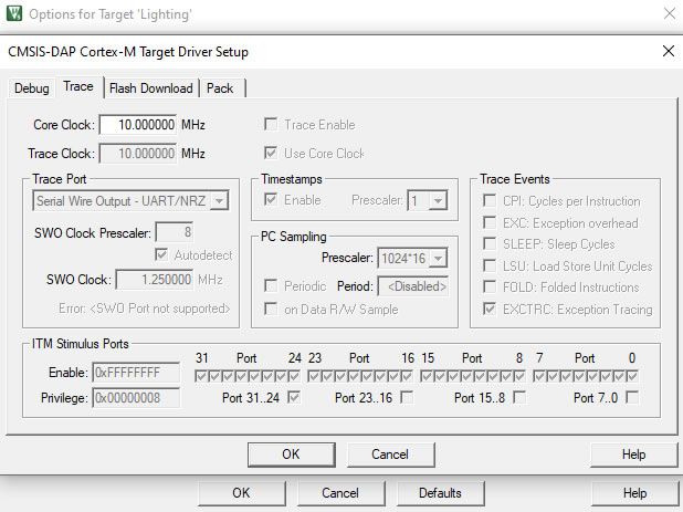

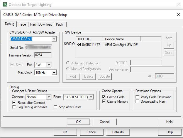

@Sebastien DENOUAL Many thanks...
I have another problem: Cannot see any printf in the debug viewer. I'm using Keil and selected CMSIS-DAP as debugger but in the trace setting the option "Trace enable" is gray, so i cannot enable it. by some searching i found that the CMSIS-DAP version has to be at least 1.1 to enable tracing. I have the v1... How to upgrade it?
