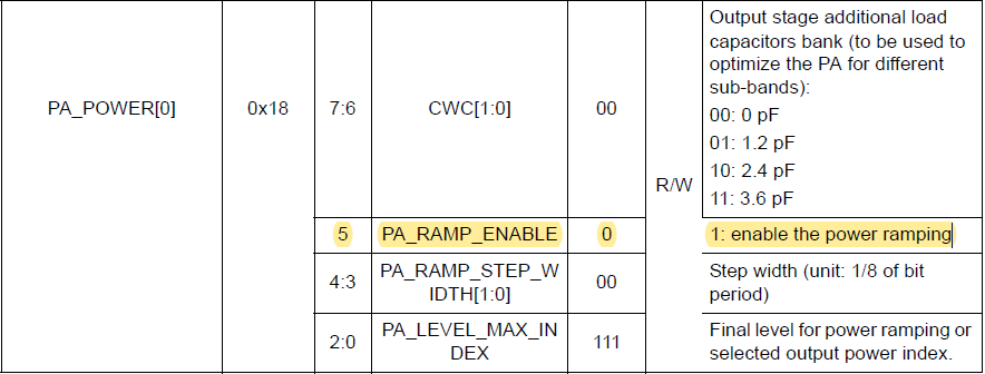

I have Contiki Coap server and client running on our two prototype boards with SPSGRF-915 module mounted on it. One node is on roof inside HVAC unit and second one is in the lab. The node on roof is not able to send data to the node in lab (in lab both nodes are communicating). I want to configure SPIRIT1 (SPSGRF-915) to maximum output power level.
This is how it is done currently;
#define POWER_DBM 11.6
st_lib_spirit_radio_set_pa_level_dbm(0,POWER_DBM);
st_lib_spirit_radio_set_pa_level_max_index(0);

Is that configuring maximum power out of SPIRIT1? If not, please suggest correct way. Thanks!

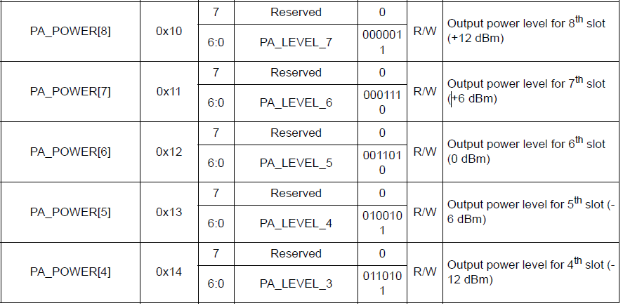

2019-12-02 7:59 PM
SpiritRadioSetPALeveldBm() would be what you need.
It is to configure the register PA_POWER[8] (address 0x10).
Please refer to datasheet, section 9 for more details about output power ramping configuration.

Hi Winfred,
Thank you for your reply.
#define PA_POWER8_BASE ((uint8_t)0x10) /*!< PA Power level for 8th slot of PA ramping or ASK modulation */
Question:
2. Which slots/PA_POWER[x]/PA_LEVEL_x should I choose for maximum power output?
I am working on STM32CubeExpansion_SUBG1_V3.1.1 SDK and want my nodes to be configured at maximum output, so that data can reach from roof to inside lab. If you need more info, let me know. Thanks again for your help.
