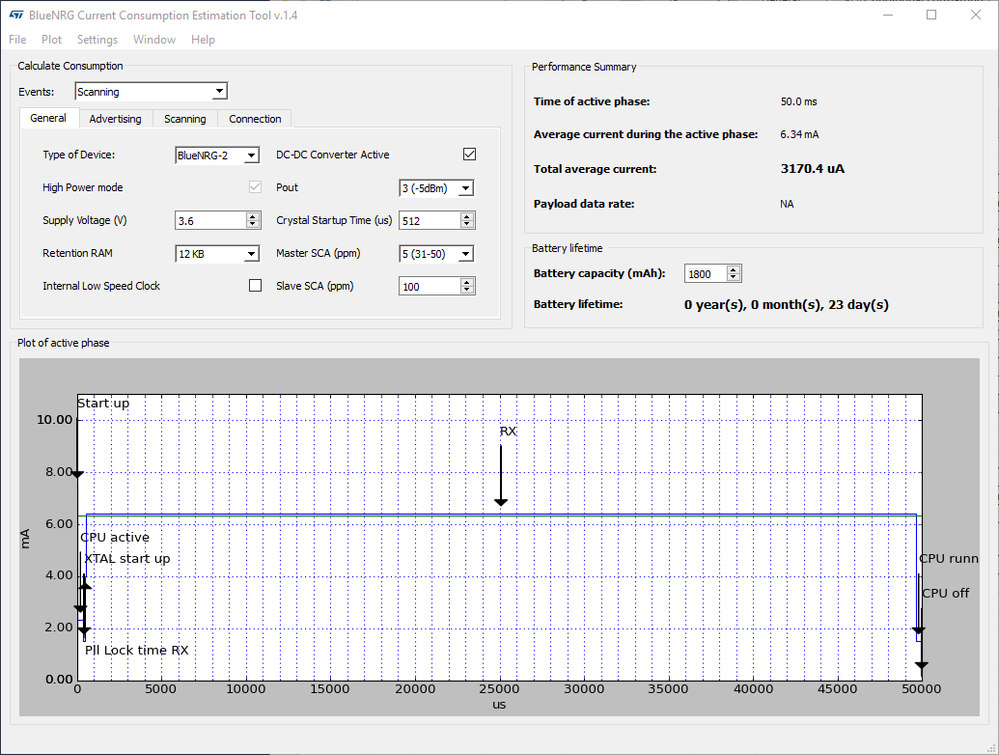

The estimation can also be got with BlueNRG Current Consumption Estimation Tool, by setting Scanning in Events:
The RX current consumption would be around 6.34 mA for the 3.6V supply voltage.
