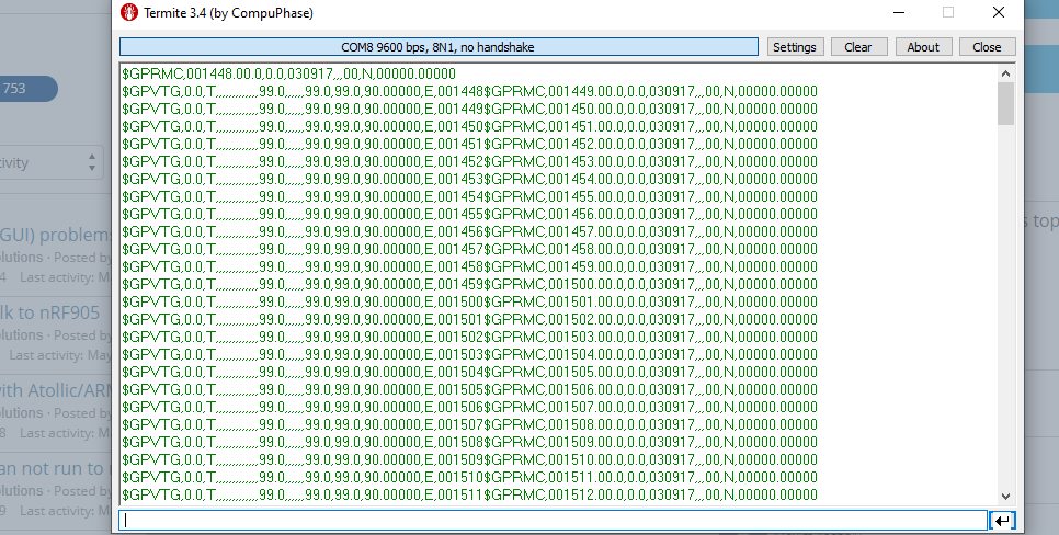

1.In my schematics, my RF section is designed without Capacitors placed(open) , is capacitor need to be added, what capacitor value would you prefer .!
2.Is we need to initialize and config for setting parameters in TESEO-LIV3F for GPRMC and GPGLL.
Please let me know about your feedback.
Thankyou in advance,suraj.N
2021-05-30 8:09 PM
GPGLL message needs to be enabled as it is not enabled by default.
GPRMC should be enabled by default, nonetheless you could send the command to enable it just to be sure.
