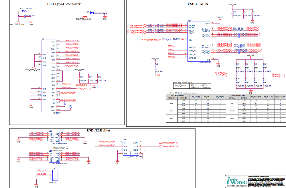

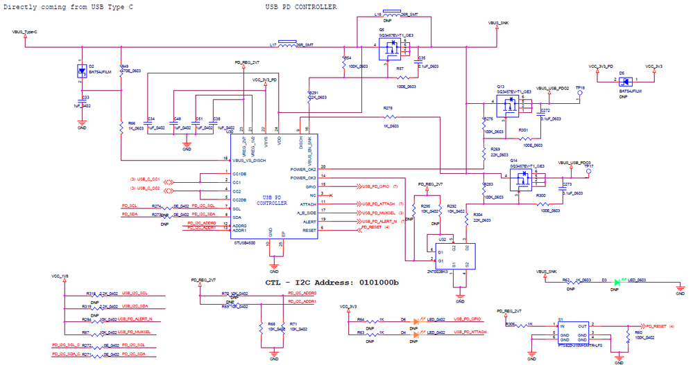

It's our own board. We are using it for PD application as well as for USB 3.0 devices alternately. Below is the schematic design for your reference.
Regards,
Vyshnav Krishnan
2020-01-07 4:53 PM
The schematic seems OK.
I think the issue is linked to VBUS which is not totally discharged before you connect the USB-C cable the 2nd time.
- Can you check with an oscilloscope the VBUS voltage when the cable is disconnected, on both side of the application (i.e. on the Source side and Sink side).
And then capture how VBUS behave when you connect the cable again.
- Capturing also CC pins (CC1 and CC2) on STUSB4500 side can also help to understand what is happening.

Even USB 3.0 device is not getting detected. The A_B_SIDE signal of STUSB4500 is used for selecting 3.0 driver IC. When I connect USB3.0 Device its detecting as high speed device not as super speed device.
- The USB 3.0 Data interface is independent of the USB PD controller.
So you need to configure properly your USB 3.0 controller if you want to use USB 3.0.
- Check the USB-C cable used
If you use a basic USB type-C 2.0 cable, it won't support USB 3.0.
For USB 3.0, you must used a full-featured USB-C cable. I.e. an EMC cable (Electronically-Marked Cable).
- Do you have a Super-Speed switch in your schematic ?
This is required for USB 3.0 support.
- How did you connect the USB 3.0 wires (SSTX/SSRX) ? Because I don't see then on your schematic.
Regards,
Gregory
2020-01-16 8:40 PM
Can you please verify this.
Regards,
Vyshnav
2020-01-17 4:10 PM
The schematic looks correct.
The issue for USB 3.0 may come from the Superspeed MUX. It could be a signal integrity issue, which can be tuned with CNFG_A1, CNFG_A2, CNFG_B1, CNFG_B2.
Please contact the TUSB542 vendor to get help with USB3.0 issues.
