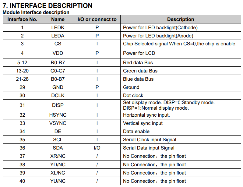

Yes you can and for connect create or order somethink like FPC FFC Cable 6 8 10 12 20 30 40 50 60 PIN 0.5 mm pitch Connector SMT Adapter to 2.54 mm 1.00 inch pitch through hole DIP PCB|Connectors| - AliExpress for your lcd
2023-01-11 2:32 AM

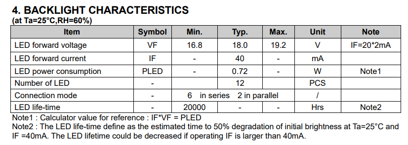

Thanks, I'll order it soon. But I'm still confused about how to set the brightness on the Nucleo. The backlight has two pins, an anode and a cathode. The forward voltage of the backlight is 18V.
