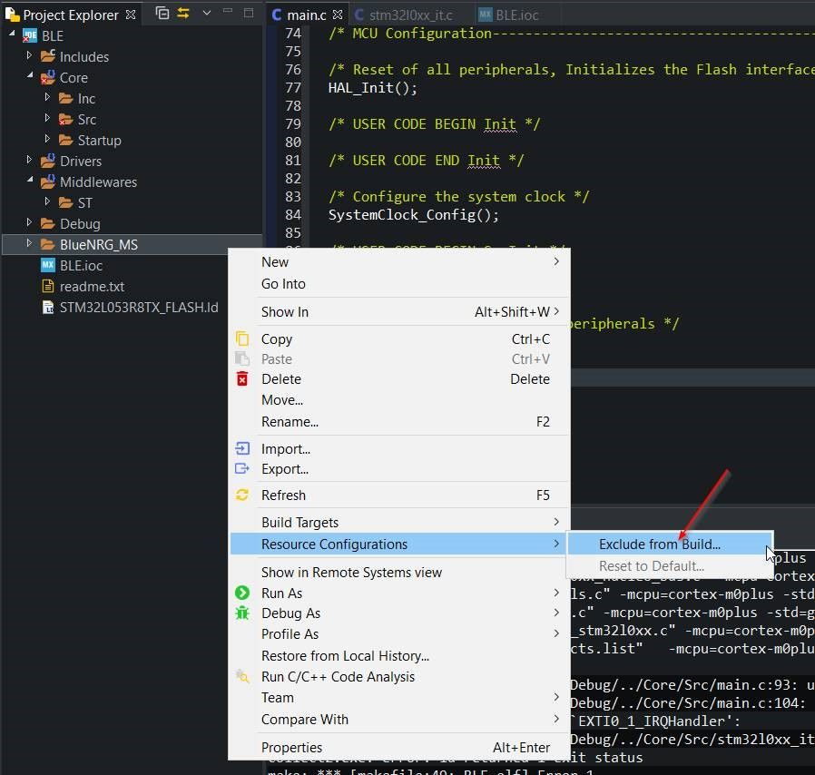

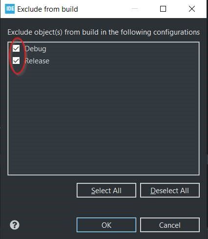

2020-07-04 7:34 PM
Apparently there is a bug when CubeMX or CubeIDE generates the BlueNRG code, the source folder is excluded from compilation by default.
You just need to include it and rebuild your project:
