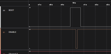

2. PIN BOOT, ENABLE is to pull-up with 3.3V via SW1 (BOOT) and SW2 (ENABLE), see the picture in attachment
3. The sequence that I did : press and hold SW2 (chip ENABLE), press and release SW1 (BOOT), then release SW2.

2026-03-18 12:25 AM
By default the BOOT is pull down (33k) and the CHIP_EN is pull up (already inside the module, no need to add external pull up). So on the your schematic, the switch SW1 should be linked to 3.3V and to enter the boot mode, you have to follow this sequence:
- Press SW1 to keep BOOT at 3.3V.
- Push and release SW2: make a "reset".
- Release SW1.
Then the module is in BOOT mode and you should be able to flash the module.

2026-03-18 8:32 AM
Hi @DHUBA.1 ,
Thanks for your response!
1. I'm setup the schematic like this, please help me to review.
2. Could you help me to check the timming and shoud I add this command after which steps?
QConn_Flash\QConn_Flash_Cmd.exe --port COM5 --config NCP_Binaries\mission_t01_flash_prog_cfg.ini --efuse=NCP_Binaries\efusedata.bin

2026-03-19 12:43 AM
Hi Giang,
I think I gave you a wrong information, there's no pull up on the CHIP_EN signal inside the module but the pull up is managed by the host (STM32). Can you detailed a little bit more your schematic ? how do you interface the ST67 (UART / SPI) ? Which host are you using ?
If you only want to to flash the module and control manually the CHIP_EN and the UART (no Host connected), you indeed need external Pull_up on CHIP_EN and Pull_down on the BOOT (see image in attachment).
In that Hardware configuration, your timing is correct.
