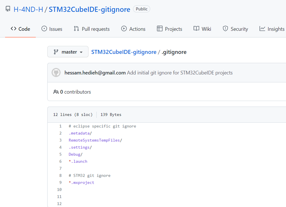

I'm using git with my project based on a CubeWL example. After wanting to add this gitignore and delete unnecessary files (i.e. examples that I don't use, but I kept the drivers of course), it doesn't work anymore...
...Git/STM32WL55/STM32Cube_FW_WL_V1.1.0/Projects/NUCLEO-WL55JC/Applications/Sigfox/Sigfox_PushButton/Core/Src/main.c:171: undefined reference to `HAL_RCC_ClockConfig'

The regeneration of the code with CubeMX seems to fix that

Are .project and .cproject files checked in?
Be sure to commit these files only when your project builds successfully.
