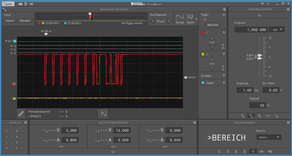

I would like to put the CAN2 interface into operation on a NUCLEO STM32F466RE board. For this purpose I have programmed an example in which a BYTE array HELLO is to be sent in the loopback.
If I now pass the TxHeader Struct to the HAL_CAN_AddTxMessage() method, this method is executed without error. The signal recording on the TX pin also shows a data transmission. It's just not the data I expected.
My data from the TxHeader cannot be entered in the mailbox register. It looks like the registers are locked, although all mailboxes report that they are free.
