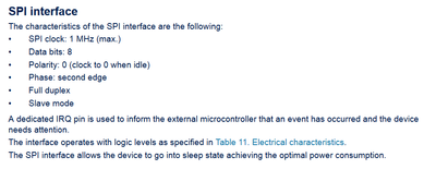

malarab
Senior II
the max SPI clock supported by the BlueNRG is 1MHz
in your case the clock is too high ! (160/64 = 2.5MHz)
malarab
Senior II
check the config on the datasheet
could you send me a link to this datasheet?...thank you.
