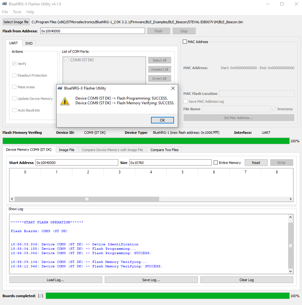

thanks for your reply @Winfred LU . I tested your advice but it didn't work. I used "BlueNRG-X Flasher Utility v4.1.0" with "STMicroelectronics\BlueNRG-1_2 DK 3.2.1\Firmware\BLE_Examples\BLE_Beacon\STEVAL-IDB007V1M\BLE_Beacon.bin" binary file and I flashed the board but still "ST BLE Sensor" app don't detect the beacon. Could it means the board is in bad condition?

BLE Sensor App may filter the unconnectable advertising packets. Please program BLE_SensorDemo image instead.
Please use some other app if you would like to receive beacons. Otherwise, the proper way to determine if beacons are sent in the air would be to use a sniffer.
