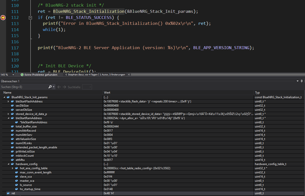

I'm trying to get the Bluenrg m2 module working. For this I use a code based on the chat demo. But when calling "BlueNRG_Stack_Initialization" I get the return value 0x48. If I am right, this means BLE_STATUS_OUT_OF_MEMORY.
For details please see the Pictures...
But from my point of view the memory areas and sizes seem to be correct. Am I missing something?
Pleas let me know if more information is needed.
Thanks!

This error may appear when you forget to define BLE_STACK_CONFIGURATION and BLUENRG2_DEVICE constants.

Thank you for your answer!
Do you mean this one in BLE_config.h:
/* This structure contains memory and low level hardware configuration data for the device */
const BlueNRG_Stack_Initialization_t BlueNRG_Stack_Init_params = {
(uint8_t*)stacklib_flash_data,
FLASH_SEC_DB_SIZE,
FLASH_SERVER_DB_SIZE,
(uint8_t*)stacklib_stored_device_id_data,
(uint8_t*)dyn_alloc_a,
TOTAL_BUFFER_SIZE(NUM_LINKS,NUM_GATT_ATTRIBUTES,NUM_GATT_SERVICES,ATT_VALUE_ARRAY_SIZE,MBLOCKS_COUNT,CONTROLLER_DATA_LENGTH_EXTENSION_ENABLED),
NUM_GATT_SERVICES,
NUM_LINKS,
0, /* reserved for future use */
PREPARE_WRITE_LIST_SIZE,
MBLOCKS_COUNT,
MAX_ATT_MTU,
CONFIG_TABLE,
};And the Prerocessor Macros:
BLE_STACK_CONFIGURATION=BLE_STACK_FULL_CONFIGURATION
BLUENRG2_DEVICE
I think it's all there. It's based on the Chat demo.

Yes I did but it was long time ago so I don't remember exact steps. I only remember that I started from changing to BLE_STACK_BASIC_CONFIGURATION and it removed an error at the beginning so I could examine the code by debugging and turning on functionalities one by one. Eventually I use BLE_STACK_FULL_CONFIGURATION without any issue.
