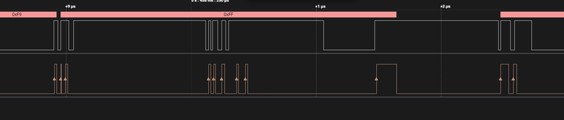

I´m using PB10/PB11 as I2C1 and PB6/PB7 as I2C2.
I2C1 works correctly.
But I2C2 not, after reset on PB6 and PB7 I just get some messy signals as below, It seems the I2C2 is not initialized with succcess.
Actually the both I2C are initialized in the same way:
