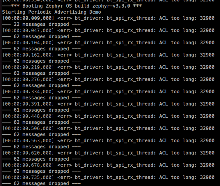

2023-04-04 5:44 AM
I am trying to configure a simple sample/periodic_adv in my steval_stwinkt1 board with Zephyr SDK.
I compiled correctly, but the application raise an error with the rx_thread,
I attach the image with the error.
Could you help me?
I configured the steval_stwinkt1.dts by myself, and I can run other applications, like hts2221 temperature and humidity sensor application.
Here the error that I mentioned before.
Thanks! :grinning_face:
