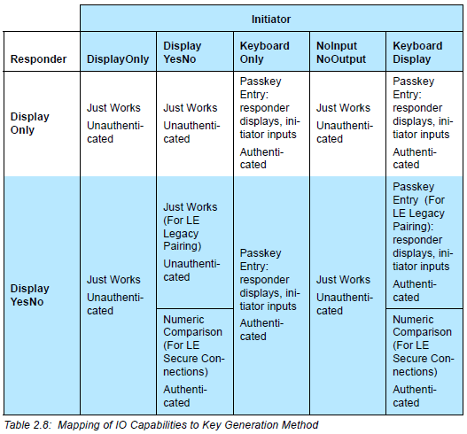

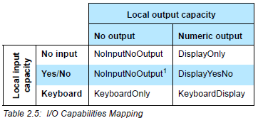

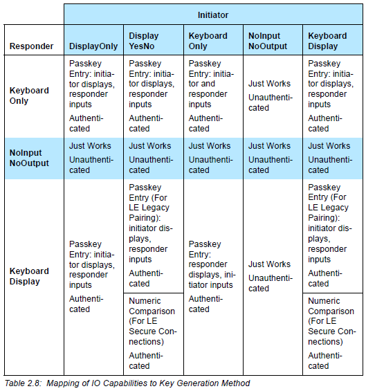

The Numeric Comparison association model is not suitable for your device, because it is designed for scenarios where both devices (initiator and responder) are capable of displaying a six digit number and both are capable of having the user entering ''yes'' or ''no''.
Since your device
has buttons w/o keyboard and display, its capacity can only be ''NoInputNoOutput''.
For ''NoInputNoOutput'' I/O capability devices, the key generation method can only be ''Just Works'' Unauthenticated.
Note.
The tables above are from Bluetooth Core Specification 5.0, Vol 3, Part H, Section 2.3.5.1
