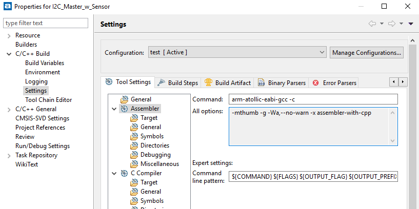

The option should be added in:
Project Properties | C/C++ Build |Settings, tab Tool Settings
for each group:
Assembler, C Compiler, C Linker
in Miscellaneouos |Other options field.
2018-06-15 12:32 PM
please select Miscellaneous subgroup in Assembler group, then white architecture option in Other options field.
The same, by analogy, for C and linker.Regards,

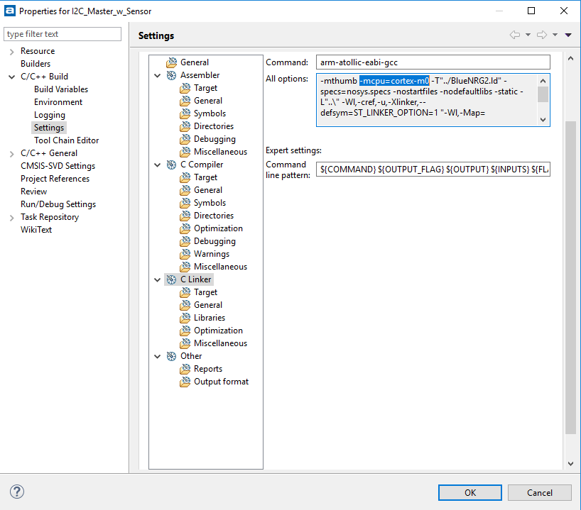

I'm new to TrueStudio and am having trouble updating the -mcpu=cortex-m0 option...
In all cases the ''All Options:'' field is grayed out and I'm unable to modify the contents (see attached screenshot). Any ideas on how to get around this?

Hi Robert,
This is the same problem I was having. I found that -mcpu=cortex-m0 was already set in the
''All options:'' field in the ''C Linker'' submenu. If you add it a second time using the
''C Linker''->''Miscellaneous''->
''Other options:'' field, it leads to build errors.Double check the ''All Options:'' field, see attached screenshot showing the -mcpu=cortex-m0 highlighted and already set. If it shows up here, you shouldn't need to add it using the Miscellaneous submenu.
