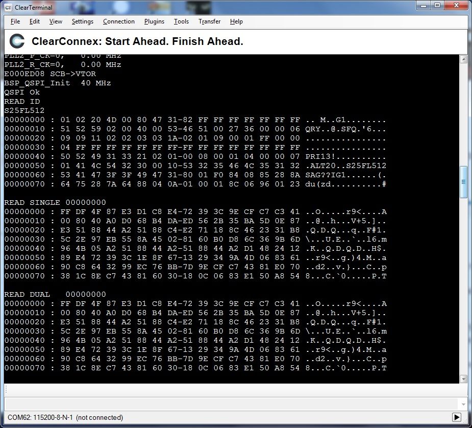

Ok, did get the parts in, and have the read, write, and erase working.

Yes, the SOIC-16 ones I can fixture. S25FL512SDPMFIG10, 256KB sectors, 4-byte addressing
