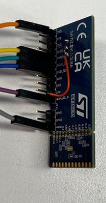

John E KVAM
I connect my L8 satellite board as in the enclosed document. (Sorry it's not a very good doc - just my notes.)
But I did cheat a bit.
Notice that LPn is jumpered to J3-1V8 and the center pin. I needed to remove the jumpers on the other side of the board. (I needed a flat front.)
But it does work a treat.
- john

John E KVAM
- john
