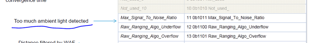

I am trying some settings on VL6180x for avoing "Max_Signal_To_Noise_Ratio" when ranginf under sunlight conditions.
I have tried to disable DMAX (#define DEF_DMAX_ENABLE 0), but still I get the MAX snr errror.
I have been trying to set other limit to SNR, Which I managed to do it, But no succes when ranging at sunlight.

Note the error is given due to high ambient light.
Do you think by using longer sampling periods I can minimize the effect of the light?
