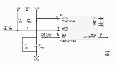

Have capacitors on AVDD and AVDD_VCSEL been placed? How is the PCB layout?

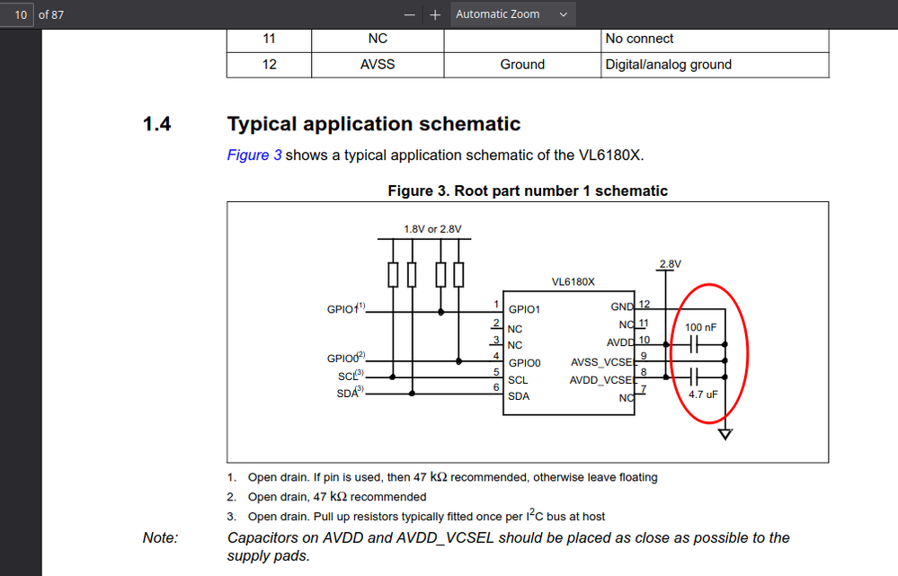

The datasheet recommends: "Capacitors on AVDD and AVDD_VCSEL should be placed as close as possible to the supply pads" which could be an indication that it doesn't have good noise immunity for the power supply.

Yes, we do have capacitors, but it looks like the Farad ratings are slightly lower than the recommended spec. Do you think that the difference is large enough to have an impact on noise stability? Our capacitors are less than 2mm away from the supply pads, too.

In these cases it is recommended to use low ESR capacitors. How is the layout?
- (From the schematic it is possible to notice that the importance of the decoupling informed in the datasheet may not have been observed, the capacitors are close together and far from the pins)

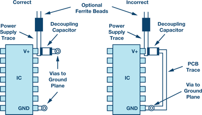

About layout, here are some tips:
Low frequency noise decoupling generally requires electrolytic capacitors (typically 1 μF to 100 μF) that act as charge reservoirs to low frequency transient currents. High frequency power supply noise is best reduced with low inductance, surface-mount ceramic capacitors connected directly to the power supply pins of the IC (typically 0.01 μF to 0.1 μF). All decoupling capacitors must connect directly to a low impedance ground plane in order to be effective. Short traces or vias are required for this connection to minimize additional series inductance.
See full text here: https://www.analog.com/en/analog-dialogue/studentzone/studentzone-april-2017.html
