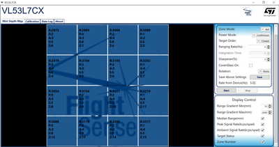

2024-05-14 2:30 AM
Hi
From your description, 3-meter target return signal rate is too low to get a valid range result.
May I know a bit more about your test setup,
Below is my test result more than 3 meter with 5hz range frequence.
Br
Zhiyuan.Han
