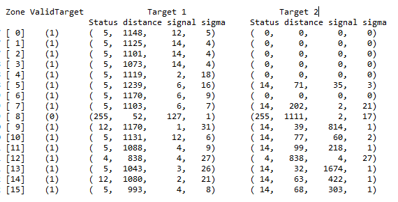

Thank you John
But after I carefully review the log, there is no neighbouring zone at 32mm with strong signal.(we use the default sharpener percent 5%)
Here are the log of the case I mention on 2024-08-22
we just focus the closest objects, so is there any settings to do with the driver?

I think you are asking the wrong question.
The proper way to evaluate the data is,
If there is a valid target, AND its status is 5, 6, 9, or possibly 12, then look at the results.
Your data shows 1 valid target. So, what is in target 2 is left over junk from some other range. It's not data.
In your zone 8 you have no valid targets. So, you cannot trust any of that data. The fact that your second target is close to what you want is just luck.
Look at zone 8's signal strength. It's 10 times as large as it neighbors. Something is wrong.
So the question should probably be, 'What is wrong with zone 8?'
And I don't know.
Is your target specular (mirror-like)? Could zone 8 be directly in front of the laser? I cannot account for such a large signal strength. Perhaps the algo gave up for some reason, and the signal strength is invalid as well.
If the issue is fleeting and you get a valid target next range, can you simply roll through this error?
If this or any post solves your issue, please mark them as 'Accept as Solution' It really helps. And if you notice anything wrong do not hesitate to 'Report Inappropriate Content'. Someone will review it.
