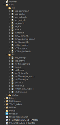

And view of my project explorer(didn't add plugin files for now):
