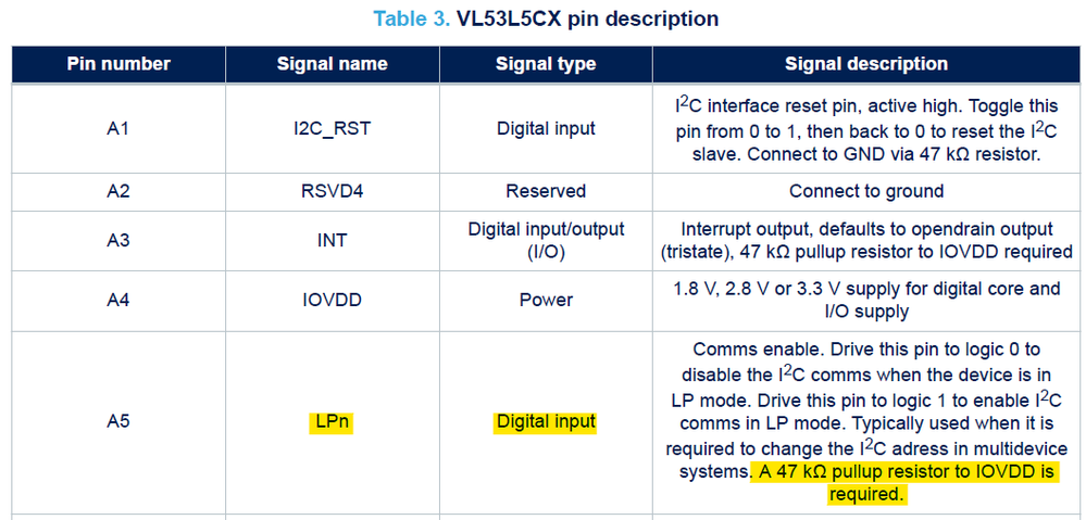

As reported in the datasheet, "a 47 KOhm pullup resistor is required" on the LPn signal.

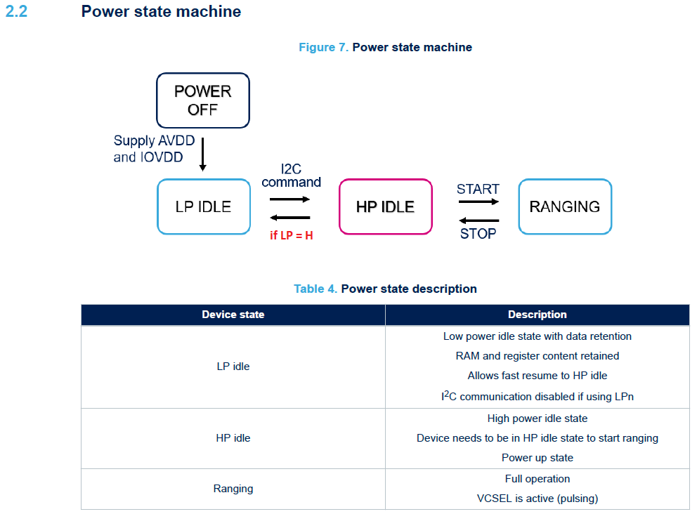

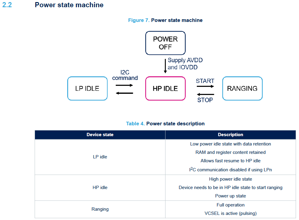

In that case the power state machine goes from POWER OFF to HP IDLE during the power up sequence.
What would the device state be if the LPn signal was low during the power up sequence?
Is it conceivable to assume that the subsequent device state would be the LP IDLE?

The trick is the LPn has noting to to with low power. Perhaps that might have been the design idea when the pin was named, but it doesn't do that at all.
Functionally the LPn is the I2C alive pin. When low, the I2C will not respond.
This is used to allow for the changing of the I2C address on a different VL53 sensor. When low this sensor will not get the command.
So at boot, you are in LP Idle, until a I2C command is received. If the LPn line is low, the one thing you can be assured of is the VL53 will not be paying attention to any command on the I2C bus.

Hence the Power State Machine block diagram (Figure 7) should be corrected as follow:
Could you confirm that the device will start-up correctly if LPn line will be tied LOW during the power-up sequence?

Well, it might be better said that the LPn's main use is to disable the I2C. (Very handy when trying to change the I2C address and you have more than one sensor.)
To issue an I2C command the LPn must be high.
The LPn is the worst named pin in the world - it has nothing to do with low power. It's only I2C enable.
(One might suppose that it's original intent was power related, but when the chip was introduced that meaning had changed, but sadly no one went back and fixed the name.)
