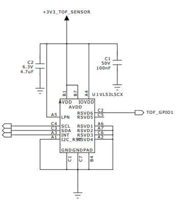

i'm new using VL53L5CX and i would start a simple ranging example.
I have setted VL53L5CX_NB_TARGET_PER_ZONE == 1 and i'm using the the example in the folder.
The init function is ok but i'm unable to start ranging. Below our schematic and my code
