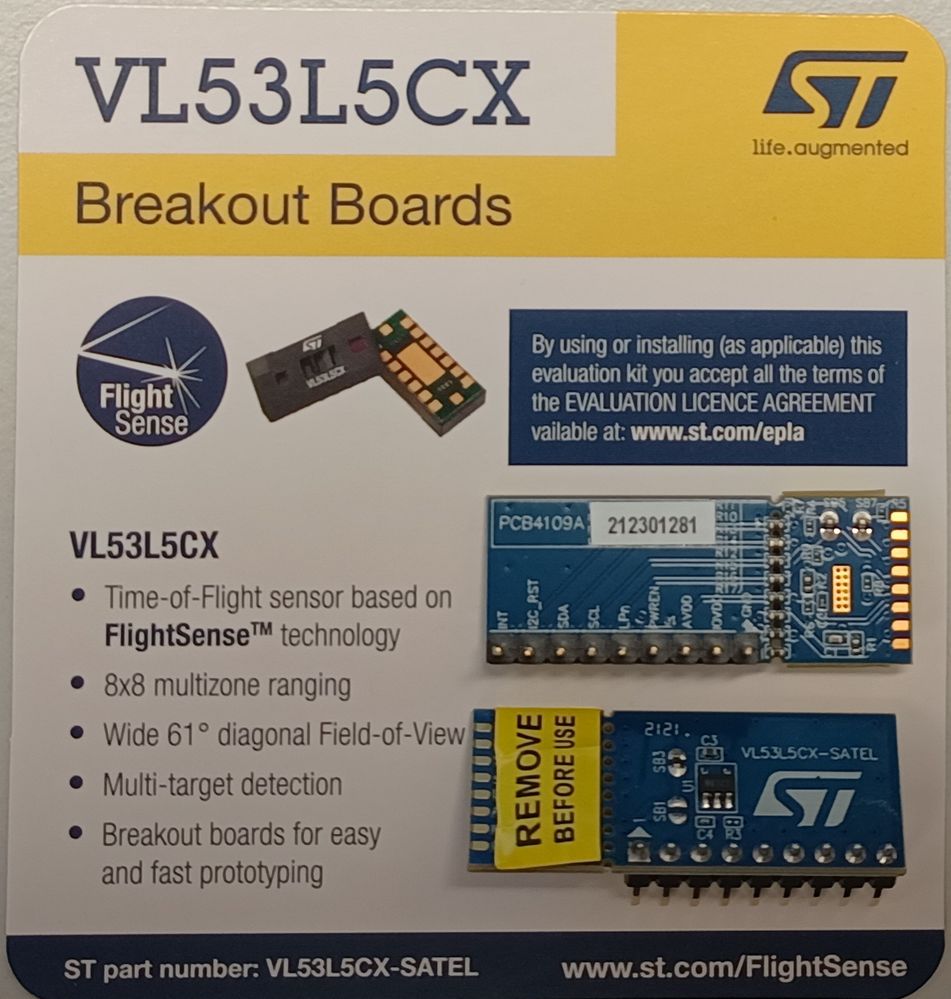

Is this the correct one? On my VL53L5CX-SATEL board there's no level shifter and only one voltage regulator (5V->3V), and the pin header signal arrangement is different as well.

I included a picture of what I have.
2021-11-22 12:22 AM
The ones we got trough retail says PCB4109A.
It seems quite different:

Well I sure learned something. When we announce a part from now on, I'm going to throw away all my prototype boards and buy some from the same place you do.
I got a promise however that from now on all the manufacturing files will be published on ST.com.
So we won't have this issue again.
Sorry about that.
