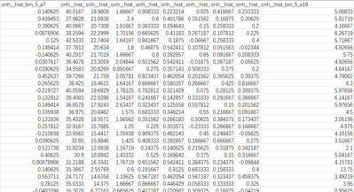

I purchased a  P-NUCLEO-53L5A1 kit and successfully used it to collect data for depth estimation with the help of Quick start guide. But I have noticed that if I used STSW-IMG024, GUI for L5, to get collected data, I would receive a .csv document and it is shown like this:
As I know, from some papers that describe principle of TOF sensors, raw data collected by L5 can be arranged as a HISTOGRAM with 100 bins. So how can I get this HISTOGRAM data (or depth data of each bin) but not just a sigma and median from a fitted normal distribution?

Thanks. I have read about these documents and got some sample data. Still, I have noticed that in the .csv document, CNH histogram data is like this:
 I have known the principle of aggregate from documents above. Yet I found no information about the unit of these data. So what is the unit of these data?
