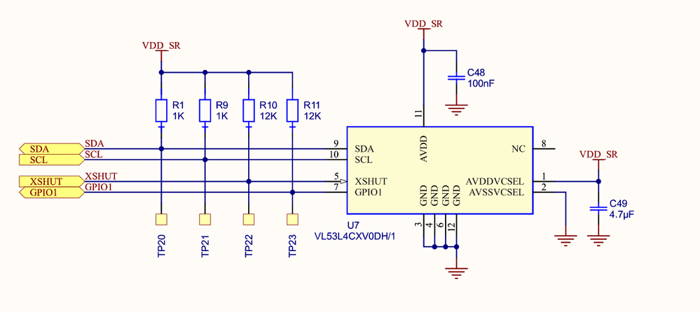

2023-08-02 3:43 AM
Hi Zhiyuan.Han, thanks a lot for your answer.
here is the schematic of the L4:
There isn't any other sensor on this I2C bus, and no other IR light on this device. The VDD_SR entry coming from LDO is dedicated to the L4.
We have checked TP20 to TP23 point with oscilloscope and there is no voltage between the periods of measures...
Regards,
Christophe
2023-08-09 3:16 AM
Hi Christophe,
Thanks for sharing schematic, seems no issue on the connection, and you shared no other noise, very strange.
