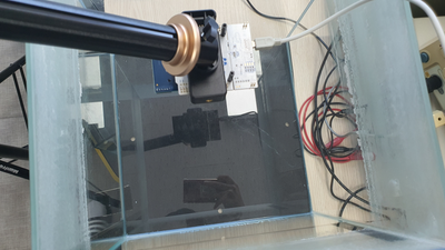

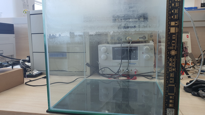

The test container and environment are shown below. (I placed a black object on the bottom of the container to lower the floor reflectivity)

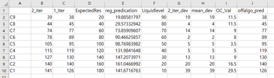

config.txt is shown below.
firmware=VL53L4CD
OCalgorithm=0
totalheight=200
offsetcalibration=100
indicators=10
characterization=2
turbu_det_std=20

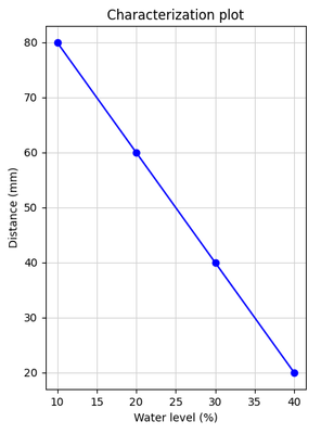

Referring to page 3 of STSW-IMG039-L4CD.pdf, when the indicators was set to 5, 4 measurement levels (10, 20, 30, 40%) were created, but the distance values of the characterization plot did not match. Therefore, the indicator of config.txt was set to 10 and proceeded. (ex, if the total height is 200, the distance of 10% should be 180)
During non-linear correction, the Characterzation button changed from Level 1 to Level 10. Sometimes the button did not change to the next level even though the level button was pressed. In that case, the level was measured by pressing the Level button again at the same liquid level.

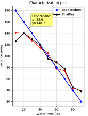

The measured characterzation is shown below.
I think it's clearly mis-measured.

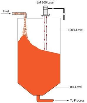

Designed for bulk solids, slurries and opaque liquids such as dirty sumps, milk, and liquid styrene, lasers operate on a principle very similar to that of ultrasonic level sensors. Instead of using the speed of sound to find the level, however, they use the speed of light (see Figure 9). A laser transmitter at the top of a vessel fires a short pulse of light down to the process liquid surface, which reflects it back to the detector. A timing circuit measures the elapsed time (TOF) and calculates the distance. The key is that lasers have virtually no beam spread (0.2 degree beam divergence) and no false echoes, and can be directed through space as small as 2 in.2 lasers are precise, even in vapor and foam. They are ideal for use in vessels with numerous obstructions and can measure distances up to 1500 ft. For high-temperature or high-pressure applications, such as in reactor vessels, lasers much be used in conjunction with specialized sight windows to isolate the transmitter from the process. These glass windows to isolate the transmitter from the process. These glass windows much pass the laser beam with minimal diffusion and attenuation and must contain the process conditions.

I think, you missed a point. If you change any data in config file, then save and restart GUI because GUI is loading all parameters at the beginning and expecting your experiment levels are given correctly. It doesn’t support to change the parameters on the fly. Other point is, if you defined ‘n’ levels then you can see n-1 levels on GUI, discarding the bottom level.
Sometimes, in the characterization, even you click the level, level is not increasing, it means reading is not appropriate or missing, hence until GUI is getting valid ranging data for that level it won’t move to next level. It helps to maintain the number of measurements corresponding to number of levels. Pls wait to move to next level to click.
I believe you maintained the water level as you defined in the GUI in characterization process.
