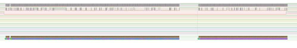

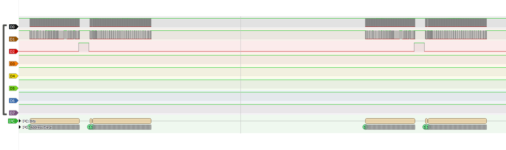

I have been looking at the I2C traces with logic analyzer and noticed some different behavior depending on which mode the device is in. It looks like in autonomous mode when the device is working the delay between the mcu receiving data and replying to reset the interrupt is minimal, while in the normal ranging mode there is a considerable delay, several milliseconds, between the data reaching the mcu and the reply to start the next ranging. The images below show the traces from the two modes, autonomous first, D2 is the interrupt signal.
Does anyone have any ideas what could be causing this behavior? I've spent a while on this now to no avail.

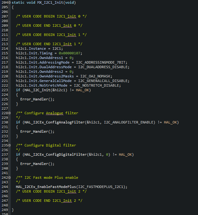

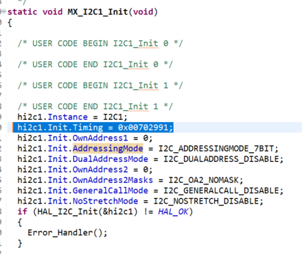

one strange thing finds inside I2C init function, seems the I2C speed is not a normal value, can you confirm that?

The I2C config is what was generated by cubeMX, I've switched to fast mode plus now and my current I2C_Init is below.
