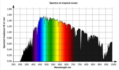

In order to compare sunlight to artificial light, first approach says sunlight spectrum is much, much, far, wider than the visible light portion. As you may imagine there are lots, insane amounts of energy at a wide range of frequencies that artificial light will not present, and cannot give, for obvious reasons.
0693W00000QKm8gQAD.pngimage credit: https://reefll.com/index.php?route=information/theory&theo_id=28
Another important approaching consideration is that there is not a unique "sunlight" as it may change daily due to atmospheric filtering, for example.
