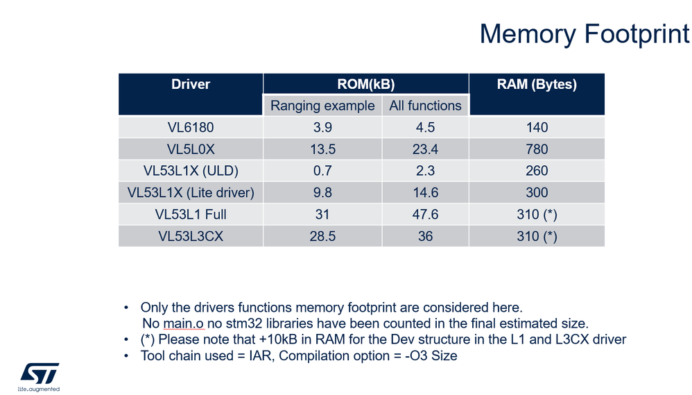

Footprint of the driver is below
If you run the ULD driver for the VL53L1X on the VL53L1CB, you will get exactly the same performance as the VL53L1X. In fact the L1CB is just an L1X with the ability to run the more complex driver.
If you were to use the L1X and ULD with the 8bit MCU it would be OK. But for the L1CB to get the extra distance it needs the power of the MCU to do some math. I fear an 8-bit MCU is not enough.
