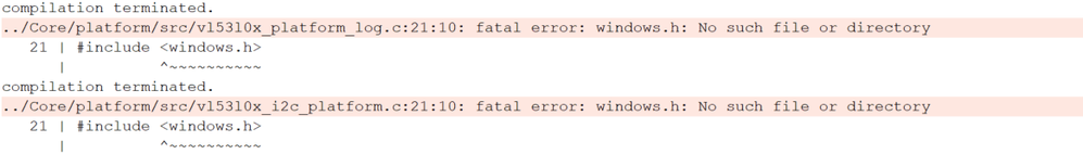

I have added all the drivers for the VL53L0X API, but I still encounter this error. Why is that?

When interfacing the sensor with your MCU, it is up to you to write the 'platform' layer. This layer actually executes the I2C_read and I2C_write commands.
As delivered, the platform layer is configured to interface to a PC using its internal bus. (It's how ST developed the code.)
No one wants that.
So, edit the platform.c file - remove all the guts of those functions (references to Windows) . You should be left with a half dozen functions that look like
Re-write those functions for your MCU.
Perhaps you don't have to the work. Look in GetHub.com for someone who has already written I2C functions for your MCU.
No one wants that.
