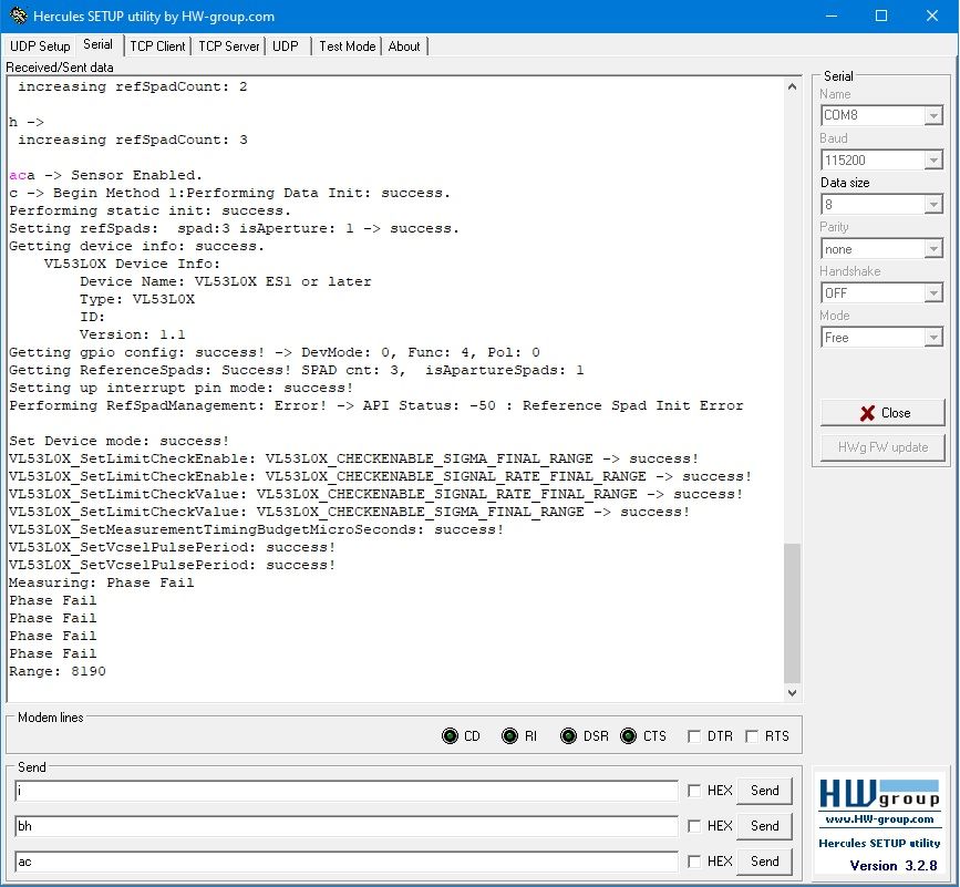

Thank you for your (1st) reply. Here is what I observe:
Only these values returned VL53L0X_ERROR_NONE from VL53L0X_SetReferenceSpads call (refSPADCount, isAperture):
I took 44 as max refSPADCount. So within the aperture and non-aperture values, only these values resulted without error.
If I do VL53L0X_StaticInit after VL53L0X_SetReferenceSpads, the VL53L0X_StaticInit call sets refSPADCount and isAperture values to: (0,0) always.
If I put VL53L0X_StaticInit before VL53L0X_SetReferenceSpads then refSPADCount and isAperture values is read as they are.
Whatever I do VL53L0X_PerformRefSpadManagement always returns -50 : Reference Spad Init Error.
However, if try to use DF-Robot arduino library, the sensor works with a 10 mm offset. When I look at the sensor with a cellphone cam, I can see the light emitted from the sensor. But no luck with the STSW-IMG005 library. I could not be able to see the light also with a cam. No methods are working as shown on examples.
Here is an example output of the firmware that I use:
We are designing a product based on the VL53L0X. We have invested a lot, and I would like to make the sensor work with the supplier supplied library not with a reverse-engineered one. Would you please help / assist me digging the reason?
Thank you in advance.
