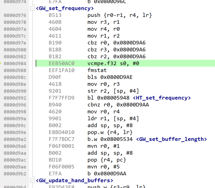

I started digging into this by stepping into the assembly for GW_set_frequency() and I noticed that the frequency parameter was not being loaded into the floating point register s0 before the vcmpe comparison (s0 always contained 0):
So I tried adding an inline assembly instruction to load the s0 register before the call, and it worked:
float freq = 1000.0/Params.RangingPeriod;
asm("vmov s0, %0" :: "r"(freq));
status = GW_set_frequency(&gest_predictor, &hand_tracker, &sensor_data, freq);
I'm not sure how this would happen, is it just a bug in the libGesturesMZ_m33.a library?

I figured out the strange issue with the library.  I created a test function that I could build and run in both environments to reproduce the problem and compared the disassembly.  I noticed that there were no floating point registers referenced in the code at all.  The other compiler defaults to soft floating point support, when I changed to hard floating point support it started working as expected.  I'm glad it was something simple.
