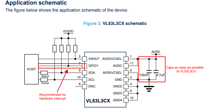

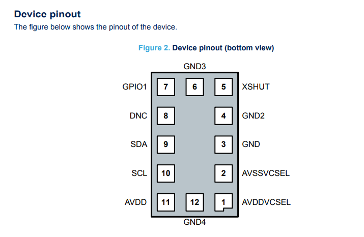

I did not find any VDDIO PIN for VL53L3X in datasheet.
Can you tell me specific PIN for VDDIO in below image.
Thank you.

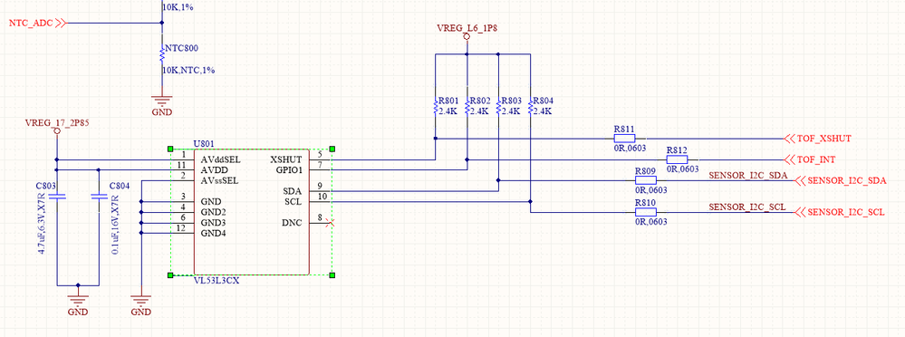

0693W00000NsOLwQAN.pngAbove is the Application schematic from Datasheet.
I have connected IOVDD to 1.8V and AVDD to 2.8V.

for an input on GPIO1, min is 0.7 times IOVDD. So that's fine. Input high has to be 1.12v min on I2C. So that is is fine as well. You are not the first. And the others worked well.
So go ahead.
