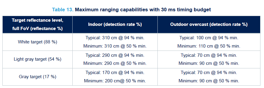

However our experimental results can not provide the quoted detection rate in the datasheet as below.

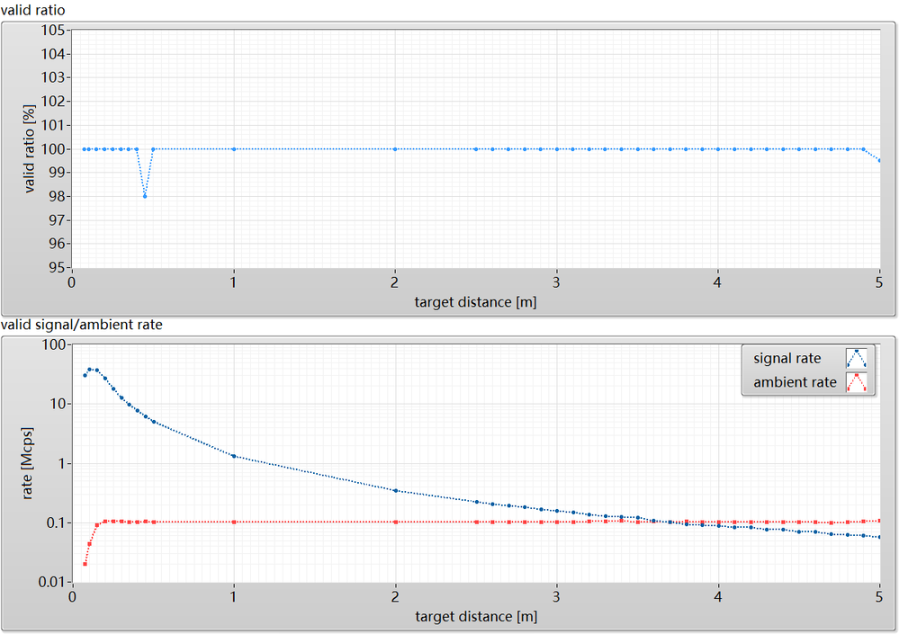

We did our tests in a dark room environment (50Lux on average with normal fluorescent lamp), and set the white wall as the target. The width and height of the wall are both larger than 2.5m for our 5m range tests, which should make sure the "target" qualified. The distance between the evaluation board and the target is allocated from 70mm to 5000mm with different step length. And we recorded 200 report values provided by your software at each distance, including the RangeStatus, signal/ambient rate, etc. Thus a detection rate changing with target distance should be generated as plotted below, along with the mean signal/ambient rate.
The ratio between 0-RangeStatus and total test number per each distance stays almost 100%! That's why I said the 50% and 94% detetction rate are hard for me to reproduce. Yes, your datasheet declares those two values are in the worst case. But an almost 100% detection rate at any given distance can not stop me having doubts on my experimental procedures.

Intuitively speaking, the detection rate must have some relation with the signal and ambient rate, and some other parameters which are not provided by your software. So I'm wondering if there are algorith or function to predict the final detection rate based on the experimental values for you to provide limits on the datasheet, as illustrated in the quoted table.
Many thanks!

In fact, we are concerning that why a LOW detection rate result can not be acquired in our indoor lab. It's critical for us to reproduce the 94%, 50% and even lower values, not an always nearly 100% 0-RangeStatus.
As described above, within 5m range in the indoor lab, we got the detection rate values always near 100%, so we are confused the meaning of "typical: 310cm @94% min; minimum: 310cm @50% min" quoted from datasheet. If these rate values are overestimated, then why public such corresponding distances?
Is it possible for us to know under what experimental condition do you get the 50% and 94% values?
