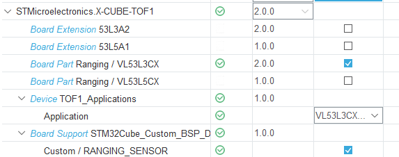

I've selected the following software packs:

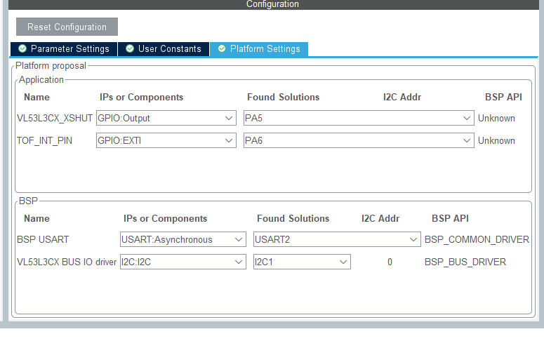

The performed the following configurations:

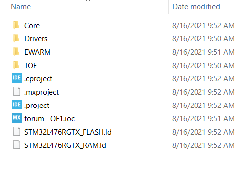

After generating the code, the directory is completely empty.

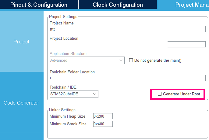

After checking your ioc received by private message , I confirm there is an issue when generating project using STM32CubeIDE as toolchain.
This issue is already raised internally and the recommendation is to generate project with "Under Root" option(ideally from scratch).
The project will be generated correctly under the main project folder.
