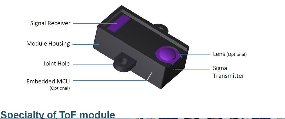

John E KVAM
​12mm is a lot. But I saw a design from CrutialTec that might work for you.
http://www.crucialtec.com/contact?lang=en
It's the same ST sensor in there, but some pretty fancy optics spread the Tx and the RX. I'm thinking this would be impervious to crosstalk.
I don't see this device on their website, but I'd contact them and ask.
