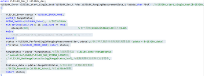

I want to reduce power consumption, but there's an error. Could you advise how to configure XSHUNT for the next measurement after lowering it?
zhy
Associate III
Hi,Han
Does lowering the XSHUT really save power? I'm using a battery!
                                         thank you
Zhiyuan.Han
Hi
Pulling down XSHUT will help to set the sensor to HW standby status, and it helps to save 1uA standby current from 6uA to 5uA.
to save battery power, I suggest you disabling the power supply directly, this will be the best case.
Br
Zhiyuan.Han
Hi
You need to pull-high the XSHUT again, and re-initialize the sensor, then perform the ranging test.
Br
Zhiyuan.Han
