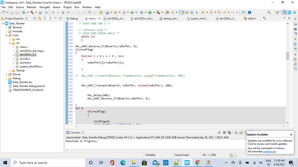

I am working with tfmini lidar and i am using USART3.However i am getting the garbage in the virtual port any idea how can i resolve this but i am getting the right header i.e YY in decimal.
Any suggestion would be appreciated.

The sensor talk to stm using I2C? I Connected sensor as per datasheet using UART protocol using rx and tx lines.Do you mean to say it is something internally that changes it to i2c?The code i wrote is extremely simple.Getting data in interrupt mode,Raising a flag in callback function and use this flag in while loop

TeslaDelorean is correct. Read the data sheet for this device.
Each 8 byte data frame starts with a 0x5959 which happens to be ascii YY, but the remaining bytes are binary. Either convert the binary to ascii before sending to Tera Term, or use a terminal emulator that provides for a hex display that is easier to interpret than garbage.
The literature says the comm is USART/I2C. USART seems to be the default.
Cheers, Hal

Oh ok what you saying is tera term doesn't support the binary number.I didn't know that.i'll try another emulator or will convert it to hex.
