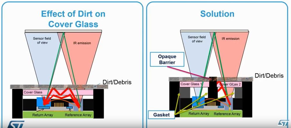

I also have seen the video https://www.youtube.com/watch?v=7INefyjvvdI talking about using a cover glass. Is there any information on how to design such a cover glass?

There are very few 'adjustments'. With your max convergence time set to max, the sensor will gather photons until it has enough and then will return an answer.
Do read the section on SNR. It will 'warn' you about marginal measurements.
​That is a great video and explains the problems and gives one solution. But you may not have to go that far. That video assumes you are building something like a robotic vacuum cleaner where getting dirty is a given. But for almost anything else a bit of clear glass or plastic is all you need. The best cover 'glass' is acrylic or PMMA or actual glass. Best if it is smooth on both sides, clear to 940nm light, thin and close to the sensor. Or if you would like there is a  company that makes them. Hynix is in Taiwan, but they have a distributor in western Canada.

I need the glass because the sensor will be in a pressure changing environment (0 to -55kPa) and may be high humidity. I was thinking something with opaque barrier in the middle. The company you mentioned is Hornix Optical Technology Inc from Taiwan (http://www.hornix.com.tw/en/product-list-3/). The thickness is about 0.85mm and I do not think it can withstand repetitive pressure changes...So DIY glass cover may be my solution.

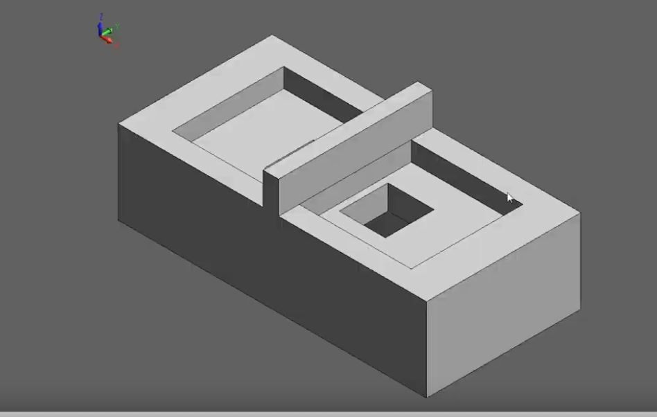

The video also mentions that the cover glass 3D model is availiable at ST.
How could I get it?

The easy way to do the coverglass is to buy it from Hornix in Tiawan. They are an optical company that specializes in molding plastics.
Otherwise all you need out of that coverglass design is some way to hold the 2 pieces of glass in and keep them optically separated.

It is the same as two years ago...
In my case...I learned FreeCAD and design it myself. I share it here in case it can be useful to anyone...
I 3D printed using a company I found on the internet.
I then cut glass from microscope plates and fitted using epoxy glue.
The results were presented here: https://doi.org/10.1371/journal.pone.0242371
