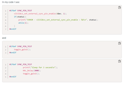

In my code I see:
#ifdef SYNC_PIN_TEST
	vl53l8cx_set_external_sync_pin_enable(&Dev, 1);
	if(status){
		printf("ERROR - vl53l8cx_set_external_sync_pin_enable : %d\n", status);
		while(1);
#endif
and
	toggle_gpio2();
#endif
			printf("Sleep for 3 second\n");
			HAL_Delay(3000);
			toggle_gpio2();
#endif
But what I'm assuming you want is how to set up the GPIO, and of course I only do this on STM32's because that's where I work.
and that code looks like this:
