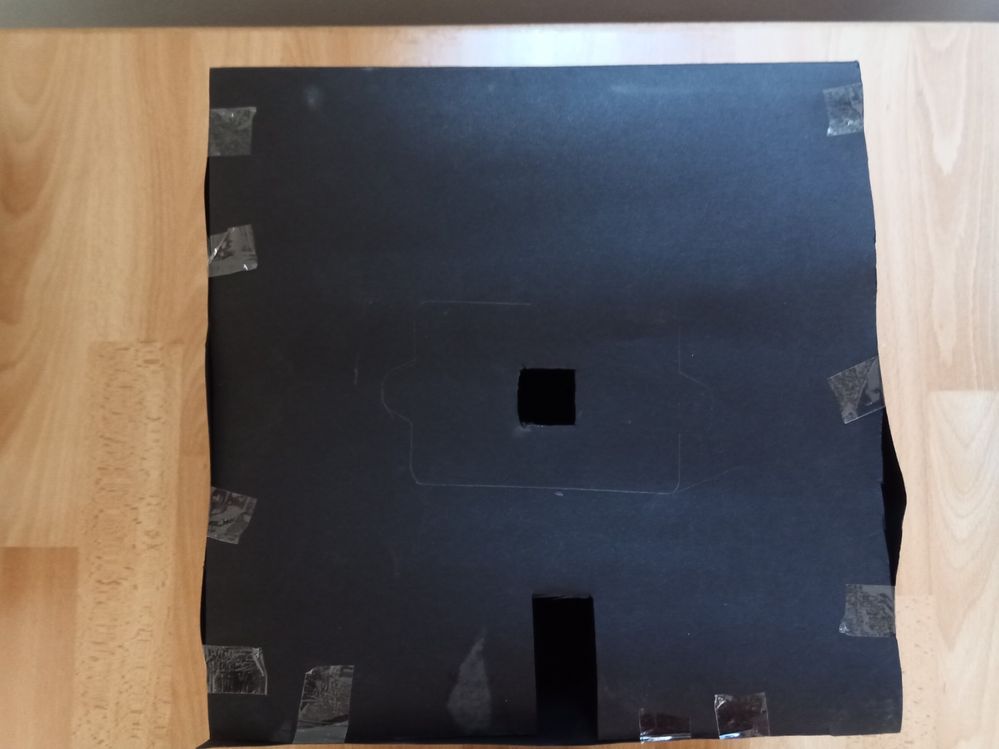

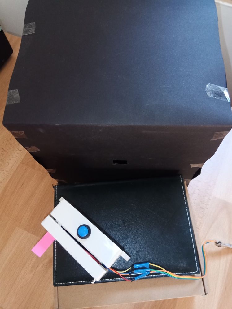

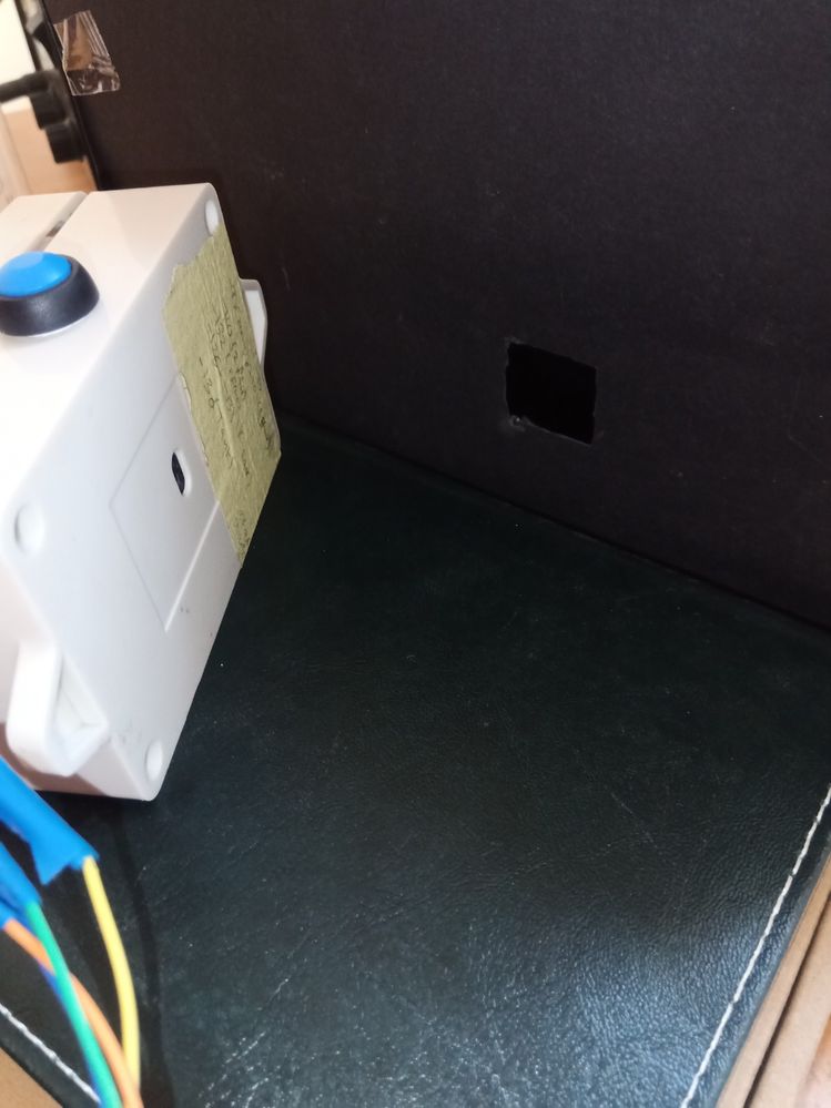

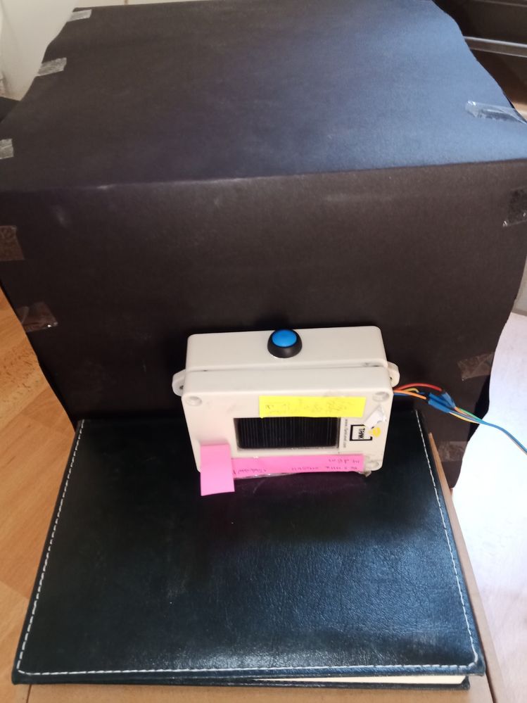

Following this topic, I've made a box out of black paper, perhaps it work for calibrating xTalk.
We couldn't get the customized paper, but here's the box with side's distance = 25cm.
The results of both offset and xTalk are inconsistent, given I'm ranging at night with room's lights off.
Any suggestion to improve the setup to accurately perform both offset and xTalk?

The light doesn't matter as long as there is no sun light. Only 940nm light makes a difference. So if you have a LED, don't take care of it, it will be fine. If you don't have calibrated paper, mate finished black spry-paint paper it is OK. The trick is to find that distance where the sensor under-ranges by 10 or 15%. If you have a good cover glass, it could be 1 meter or 2. With a bad cover glass, it could be 30cm. The size of the paper has to be at least as large as one half the distance to the sensor. If your paper is large enough it is fine.
You are saying your results are inconsistent. If there are 5% different, it should be fine. Use the worse number. The penalty for too higher numbers is a slight inaccuracy. The penalty for too lower numbers might be a ghost image.
You don't need a box to do the calibration of the cross-talk. You need a larger distant (moreover if you have a good cover glass).
For offset, you need a brighter target. White paper at 140mm works fine.
Best regards
Anne
