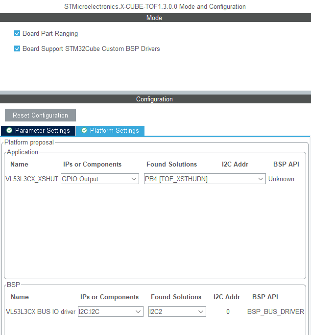

To be more precise : I have added&setup 2 packages in my project.
In my MX 's project >> Software Packs >> STmicroelectronics.X.CUBE.TOF1.3.0.0 Mode and Configuration I have :
☑�? Board Part Ranging
☑�? Board Support STM32Cube Custom BSP Drivers
Thanks for help.
