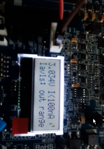

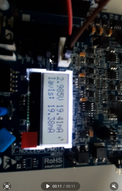

We just did a test using :
- a 53L0-SATEL-I1
 - a X-Nucleo-LPM0A1 board from ST for power consumption measurement as per the pictures below :
here are the results of our tests :
with the X-SHUTdown connected :
We got : 5.4 µA
And with X-SHUTdown disconnected we got :
We got : 6.1 µA

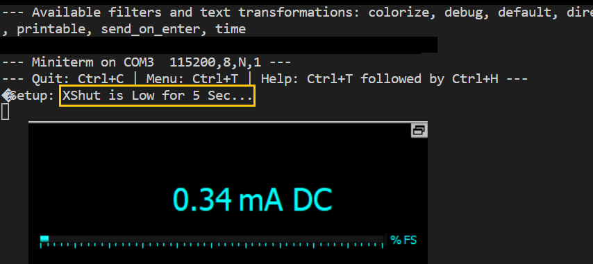

Thank you Julien for your reply, i made 2 kinds of measurements one with XSHUT pin connected to the microcontroller & the Other I disconnected the pin. the firmware cycle is:
1- Wakeup (Ideal)
  • With XSHUT = 0.34mA
  • Without = 0.01mA

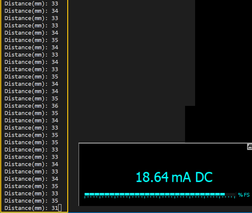

2- Measuring
  • Same for both = 14.5mA (With Budget 20mS).

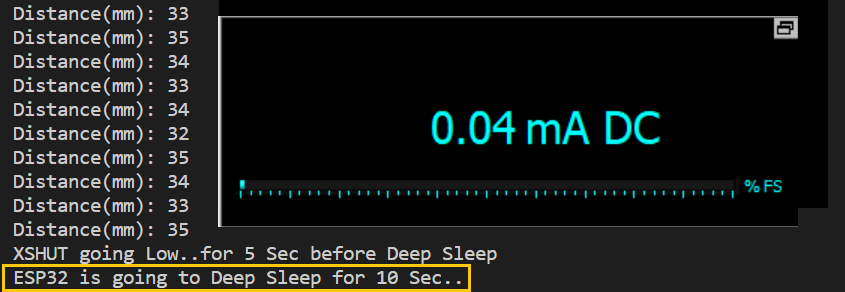

3- Sleep
  • With XSHUT = 0.04mA
  • Without = 0.01mA

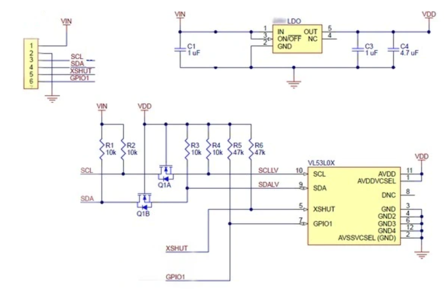

When you say unconnected, do you mean that you do not control the xshut down pin but you connect this PIN to VCC via a pull-up resistor?
Yes, according to the schematic of the breakout board of the Sensor that I have:

I'm going to guess that if you have a pull-up on the Xshut line, you need to burn power to pull it down. And that is where you are using the power. With the Xshut down held low, that senor is basically a brick.

1- This is not the 47K pull up resistor who burn 312uA ! :thinking_face:
So why when Xshut is low there is still a consumption ?
