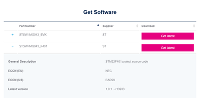

Anne BIGOT
Going to the STSW-IMG043,
you can see in the get software section, some sub-package.
To get the code for F401, please upload the STW-IMG043_F401

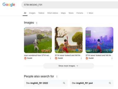

Ah yes, that works - there was a typo in your previous post:
@Anne BIGOT wrote:
For option2, the code is part of STW-IMG043_F01 sub package
