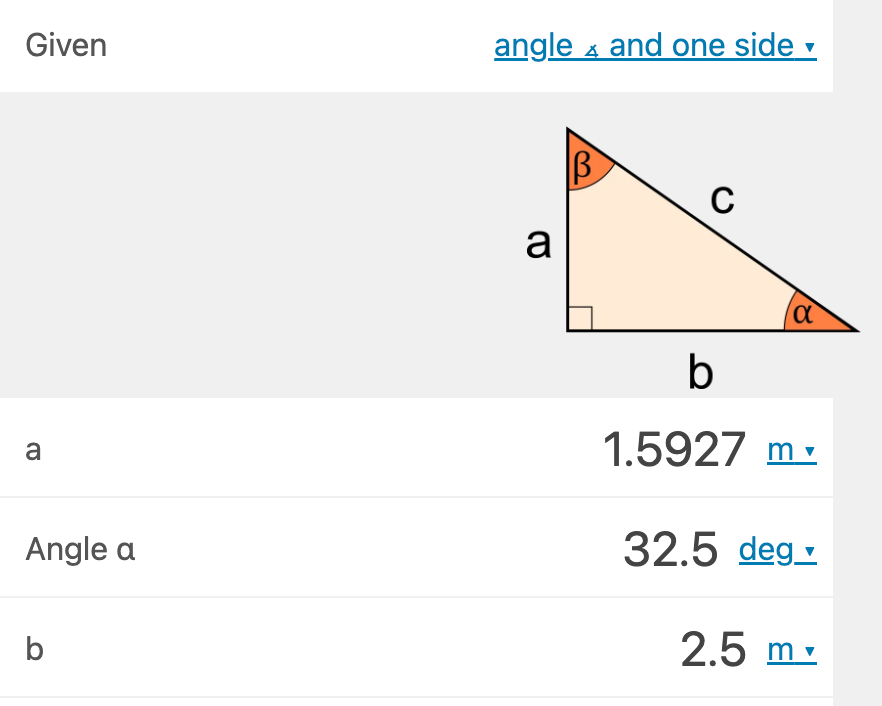

I got a VL53L5CX sensor from SparkFun and I've been playing around with it in the past few days - it seems to be surprisingly accurate and so far has exceeded my expectations.
One thing I'm struggling with is understanding what is the effective projected FoV.
I've placed the sensor in my ceiling, which is 2.5m tall, looking down. Since this sensor has a diagonal FoV of 65 degrees, I'm I right in assuming that the projected FoV on the floor is ~1.6m (2.5m is the height of my ceiling and 32.5 is half of the diagonal FoV)? And if so, would each zone in the 8x8 grid actually correspond to ~20cm2?

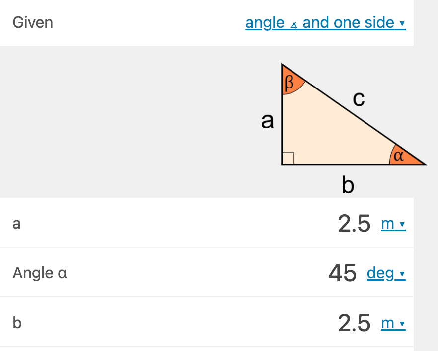

This is more or less in agreement with what I've seen empirically (~1.65m2), but for my use case I would like the sensor to capture an area on the floor of about 2.5m2.

Welcome to the Community Alix !
Regarding the different FoV definition, you can find some details in the AN5894
It will give you an answer to the question 1. and hopefully to the question 2 :)
Be carefull to the max distance the sensor can reach depending on the light conditions too.
