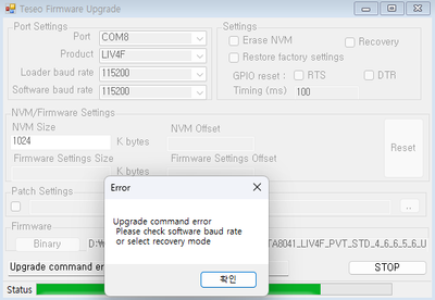

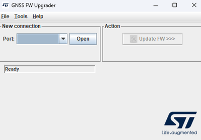

After updating x-nucleo-liv4a1 using the GNSS FW Upgrader program, it no longer works.
Afterwards, I tried to update using Teseo Firmware Upgrade, but an error occurred.
How can I revert a module?
Thank you.

Hi Leo,
To upgrade firmware for X-NUCLEO-LIV4A1, can you use a USB to UART cable and connect to the UART-TX and UART-RX pins directly? The firmware upgrade tool in the X-CUBE- firmware directory is only tested for LIV3 and VIC3 modules.
Hardware modifications are these:
In Teseo Suite, can you try checking the flags Erase and Recovery?
After you press START on the Teseo Suite, please press and release the reset button on LIV4F.
Please try this and let me know.
Thanks,
George
